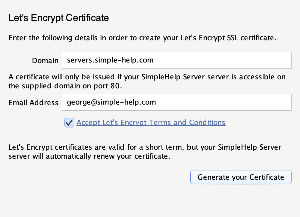

Let's Encrypt Certificates can automatically be generated by SimpleHelp for any server that Let's Encrypt can verify. When creating a Let's Encrypt certificate you will be presented with the following configuration:
Let's Encrypt Screenshot
Domain The domain name of your SimpleHelp server. This should not include the server ports or any protocols..
Email Address The email address of your server administrator.
Validation Type Select the appropriate option so that Let's Encrypt can verify your server. If your server is available on port 80, choose HTTP. If it is available on 443, choose TLS. Alternatively, you'll need to configure your DNS manually for verification.
If your SimpleHelp server is accessible on multiple domain names then you can generate certificates for each of these by specifying them as a comma-separated list:
domain1.simple-help.com,domain2.simple-help.com,domain3.simple-help.com
Let's Encrypt will validate the domain name entered, so it must match the address of the SimpleHelp server, and must be publicly accessible port 80 or 443. Additionally, the email address will be used to notify you when your certificate is due to expire. Since certificates are free they are valid for a short period. Once a Let's Encrypt certificate has been set up SimpleHelp will automatically renew the certificate for you a week before it expires.

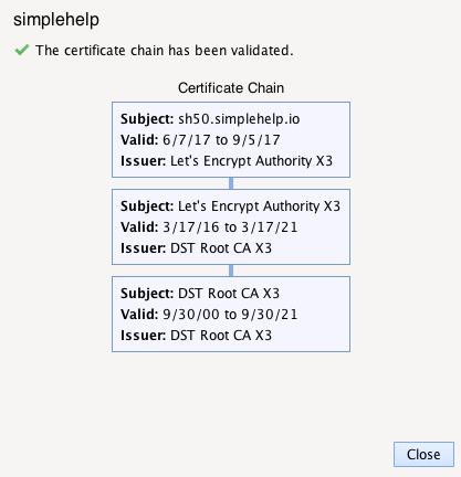

Viewing the Keystore Details
Clicking the button View Server Keystore Details will request the current keystore details from the SimpleHelp server and will notify you whether the certificate chain is valid. If it is valid, each certificate in the chain will be listed, as follows:
Validation Screenshot

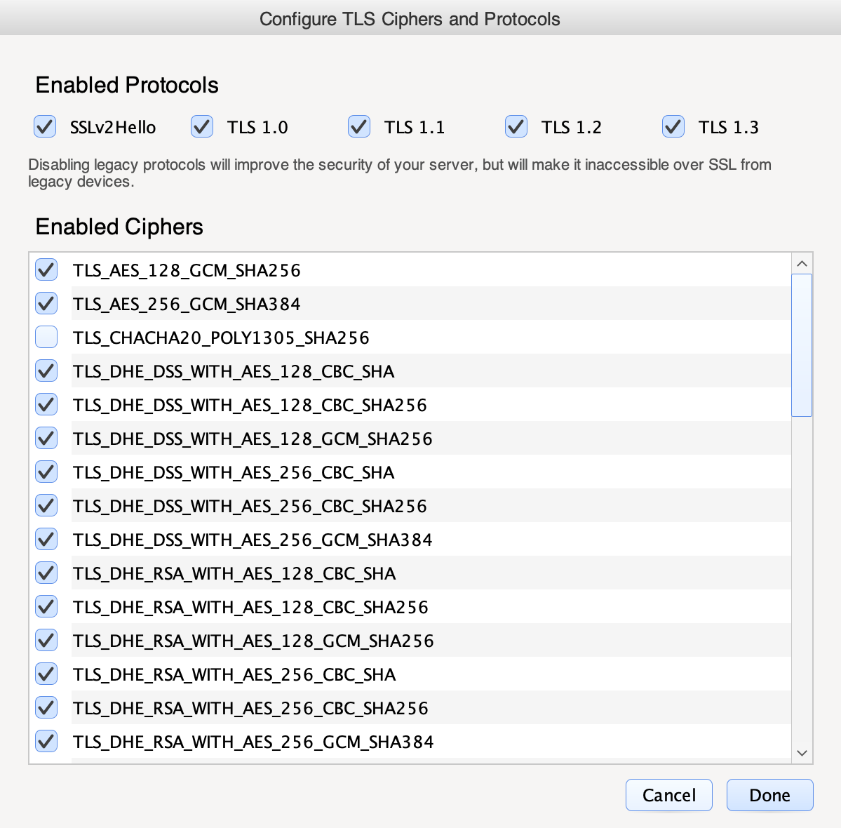

Ciphers and Protocols
The set of enabled ciphers and protocols that the SimpleHelp server accepts can be configured. By restricting the ciphers and protocols you can control how clients communicate with the SimpleHelp server over SSL / TLS.
To configure the Ciphers and Protocols click on the Advanced Configuration button, which will present the following dialog:
Ciphers and Protocols Screenshot
The optimal configuration for your server will depend on the devices you wish to support. Older operating systems and browsers will be limited in the ciphers and protocols that they support. By restricting the SimpleHelp server you will increase the security of secure communications but will prevent certain devices from connecting.
