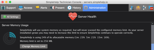

Screenshot
SimpleHelp v5.1 reports memory usage metrics and includes the ability to change the memory used by SimpleHelp from the Administration tab. Log in as a server administrator, switch to the Administration tab and select the Server Health section.
Once the memory limit has been set SimpleHelp will need to be restarted at a convenient time.
